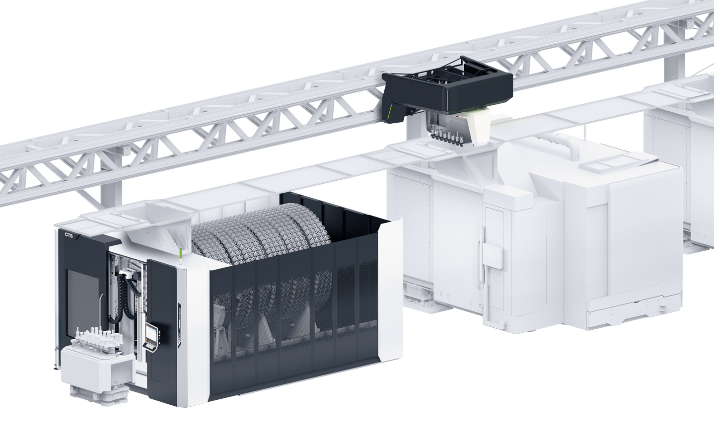

CTS – Central Tool Storage (Wheel type)
  • Modular concept with step-by-step extension possibility by 360 / 240 shapes (ISO 40 / 50 recording)
  • Very small footprint with only 29 m2
  • Integrated tool loading solution for portal tool shuttle or with AMR 2000 tools
  • Highest transport capacity through the tool - shuttle
  • Transfer of up to 8 tools simultaneously
  • Proven wheel magazine technology with over 1,600 units sold

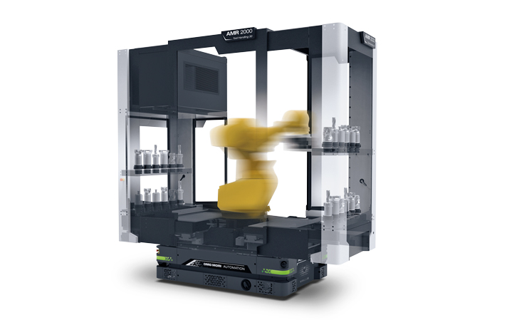

AMR 2000 Tooling
Portal tool handling
Tool transfer
AMR 2000 Tooling
  • Autonomous transport of up to 24 tools between the CTS (central tool magazine) and the machine
  • Quick installation of the automation system
  • Integration into existing production possible
  • Max. tool dimensions ø 280 / 650 mm
  • Max. tool weight 30 kg
  • transport weight 720 kg (24 × 30 kg)

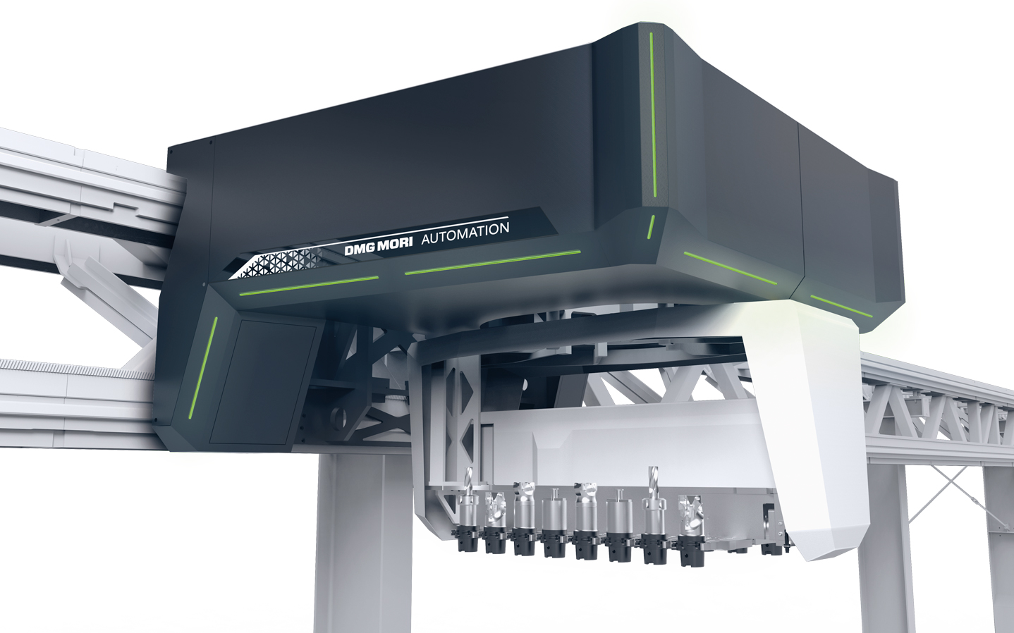

  • Portal tool handling for highest efficiency, transport of up to 80 tools per hour.
  • Transport of 16 tools (2×8 units)
  • Fast tool change by means of rotating unit
  • Max. linear speed: 80 m/min
  • Tool Loading Station TLS - interface on machine and CTS
Tool transfer
  • To change tools between the shuttle and the machine or on the CTS, the TLS moves upwards in each case.
